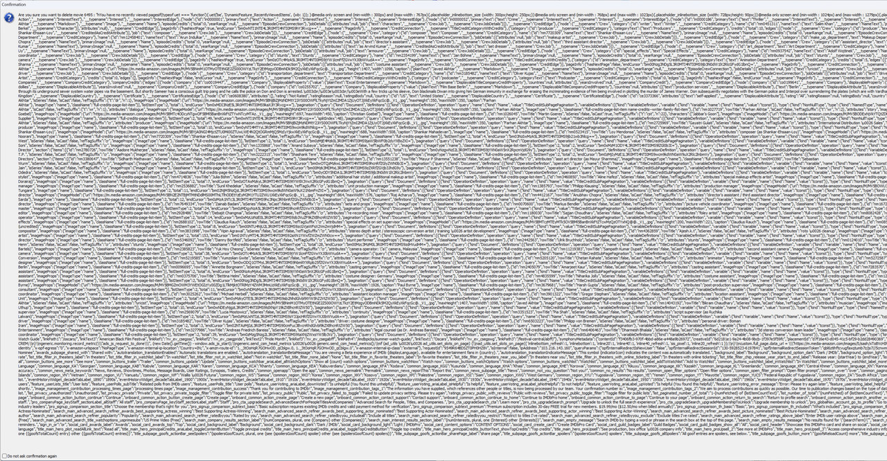

Thereafter, if I try to delete the movie information for which the script was run, that 'delete' function hangs. The catalog doesn't even let me enter the original title of the movie--the field remains blank though the catalog registers the keyboard strokes--manually (all the other fields except 'original title' accept manually typed data). I have to use the task manager to close the catalog.
I have uninstalled and reinstalled the catalog but the issue persists.
Now I can use the catalog only if I create a new entry manually all the way through. If I use a script, any script, one of the two failures posted above appears and the entry becomes a fixed dead entry in the catalog in the sense that I cannot even delete that entry (and it imports information only in the URL and 'Comments' field. I use the IMDB script and all the other fields remain blank.
Here is what I get when I try to delete the 'dead' entry:
At this point, 'end task' in task manager is the only option that works.
Any help would be much appreciated.

The script incorrectly parsed the page and created an entry with a really too long value in one of the fields I suppose.
You saved your catalog with that corrupted entry? :/
You can try to make a new catalog and import the old one in it, excluding the "dead" entries, but I'm not sure it would work.

antp wrote: 2025-06-11 15:24:14 The script incorrectly parsed the page and created an entry with a really too long value in one of the fields I suppose.
Antoine, thank you very much for saving my catalogue; the catalogue is a work of twenty years and has 7000 titles and I can't imagine losing all this work without the possibility of retrieval. Your suggestion to import the titles, excluding the corrupt ones, worked like a charm.
However, the main problem remains: each time I search a title on IMDB, the search works fine, but the information import window then imports only the URL and the comments:
Thereafter it gets worse. If I save this information, then the title field goes blank and I cannot even manually type anything in that field. This particular entry then becomes impossible to delete. And thereafter none of the scripts work correctly: all the scripts begin generating the problem created by the IMDB script.
Your suggestion has saved my catalogue, thank you very much. I hope the problem created by the IMDB script can be resolved soon because it has rendered the catalogue unusable. I have no choice but to make entries manually in every single field if I want to add new titles to the catalogue.
