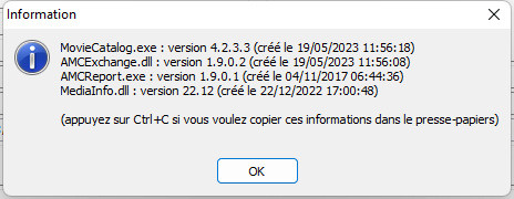

LeMoi wrote: 2025-06-20 23:24:17 Hello and thanks for latest updates.
I have an error while launching the script, 'A call to an OS function failed', what could be the cause?
I use AMC 4.2.3
Thank you in advance
Go in Help -> Version and check if you get these version numbers (4.2.3.3)
These are mine version numbers:
MovieCatalog.exe : versione 4.2.3.3 (creata il 19/05/2023 11:56:18)
AMCExchange.dll : versione 1.9.0.2 (creata il 19/05/2023 11:56:08)
AMCReport.exe : versione 1.9.0.1 (creata il 04/11/2017 06:44:36)
MediaInfo.dll : versione 22.12 (creata il 22/12/2022 17:00:48)

I have these :
It looks the same...
I tried with latest RC 2, same problem

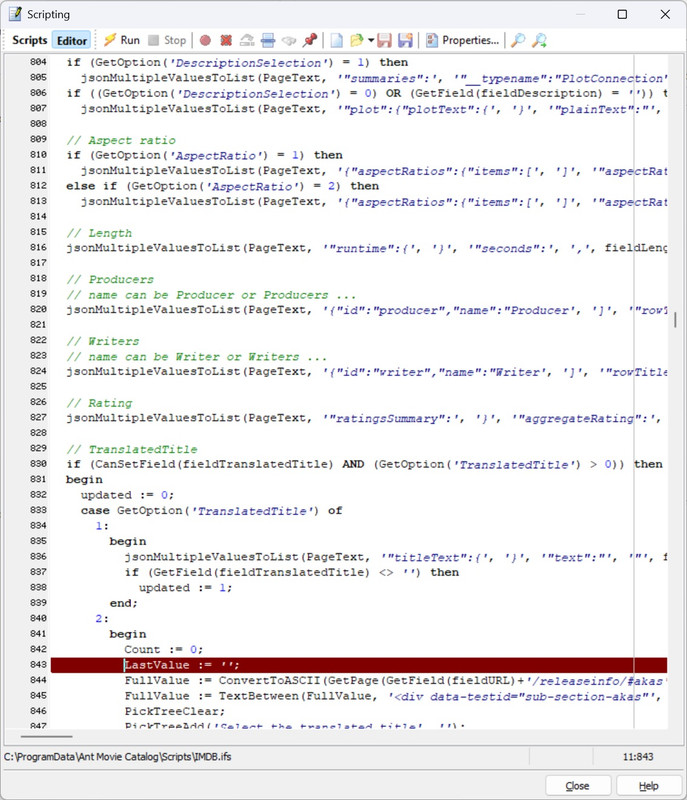

IMDB Title/URL: Wallace & Gromit: A Grand Day Out / https://www.imdb.com/title/tt0104361/
Error: "Script error in "IMDB": unknown identifier: LASTVALUE at line 843.
Here is a screenshot of the error (after I get the error listed above, the script takes me to this in the 'Editor' tab:
I tried another title https://www.imdb.com/title/tt0312004/ and got another error (which I didn't note down).
I went back to 5.0 release candidate 4 and these errors disappeared. Everything working fine in my catalogue thus far with RC4.
Thank you for all the splendid work you have put in MrObama and wish you all the very best for the home run.
