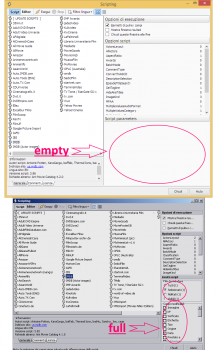

I installed 4.2.0.2 on Win 8.1 64bit pro
When I try to execute a script, in the window the script parameter area is empty. Maybe a rendering problem, when I focus the area I can read "Double click on a parameter to change it".
With 4.1 on Win XP 64bit the area is not empty.

There is no script parameter for IMDb, so it explains why that is empty here. That feature didn't yet exist in the other version you had before, I suppose.
However below that there should be a "script limitations" block ("Limiti script") like what you circled on the old version screenshot...
Nothing changes when you resize the window, I suppose?
If you try to maximize it, close it and then reopen it maybe?

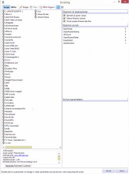

No, there isn't another block after "script limitations". Here another screenshot:

mrobama wrote: > However below that there should be a "script limitations" block ("Limiti script") like what you circled on the old version screenshot...
Well what I meant is that normally there should be one, as indeed I saw it was missing on your screenshot ;) (as I said, it is normal that the parameters block is empty in this case, it is a new thing)
Thanks for the config file, I wonder how it can cause that, maybe soulsnake will have an idea of what could have happened.
If you wish to keep your old XML config file, it is probably easy to fix: the problem is on the line containing
DockpanelLimitations Rev="2000" Visible="0"
visible is set to 0 instead of 1 for an unknown reason... (normally the visibility of that panel can't be changed by the user)
